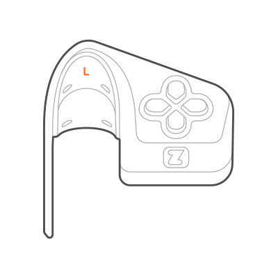

| Left Zwift Play controller |

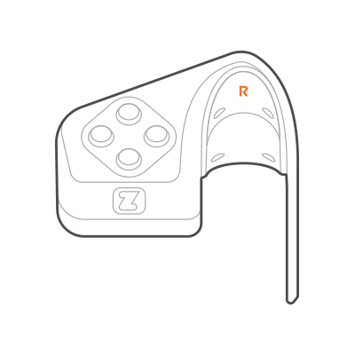

| Right Zwift Play controller |

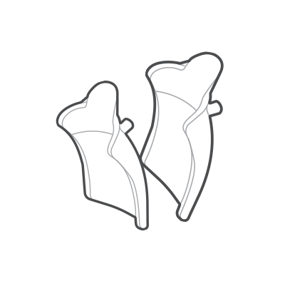

| Handlebar spacers (×2) |

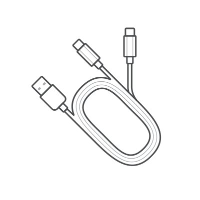

| Charge cable |

Use provided cable to fully charge your controllers. The Z logo button will pulse green while charging. Find out more about the LED states on page 22.
